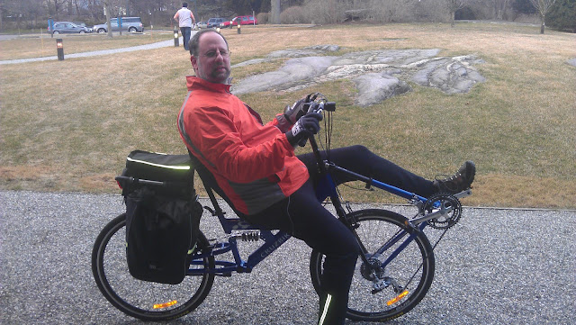

Hello,
when pushing on the Sofrider I (6ft) did not like the feeling that I pushed at a downwards angle. I once tried a HP Speedmachine and loved its forward push feeling, having no problem with its 30 seat back .
Saturday night I envisioned a smaller rear wheel to rise up my feet on my Sofrider V3 - like the late Valdo's model:
I even ordered a 20" wheel on Saturday night, but woke up on Sunday morning and immediately got the idea to put the 16" front wheel of my HP Spirit - a short LWB recumbent - in the position of my Sofrider's back wheel to get a more reclined position while keeping the good body angle I set up while riding on the home trainer.
So we have - both unused - a SON dynamo and a Magura Julie brake disk there. I inflated the tire to just under 5bars (70psi), that was OK:
Unused Tektro back brakes - I rode cautiously, and the front brake was enough. Keep in mind that I was just position testing on lonely roads well-known to me, never take risk at this!!
A lot of space for the bag:
...and a more reclined position, which I really enjoyed, I only made small adjustments to the leg length:
Well, it does not look fast or sexy, but it felt comfortable and swift, and the feeling that the feet were higher was good!

To calculate the angle change: the 16" wheel's radius is about 195mm, the normal 26" wheel's radius is about 315mm, so the back axle sunk by about 120mm. This leads to about 6 more recline - at a wheelbase of 1110mm (taken from the data sheet).
The steeper steering tube angle means you need more force when straightening the steering wheel at the end of a turn, but this was unnoticed with one possible exception: when I tried a slow&tight turn on a 2m wide lane, I did not manage to stay on the tarmac, got into half-high grass and was practically stopped by the uneven ground - the bike fell under me - one possible reason for my failing might be the added force to upright the front due to that steeper angle. But this was extreme.

Regarding the seat pan position: yes it can be moved backwards, as it is in the second most forward position currently. But then the knees are likely to touch the bar, they have ~1" clearance now. I will surely have to turn the stem backwards. And I expect the effect to be comparatively small: If you move the crank back 5" - the stem position change will yield maximum this - you might get 2"-3"of that as height gain for the BB. So even if I would use a longer stem, this might come handy for the fine tuning, but will not raise my feet 100mm or more.
Next I will put 40mm shorter shock - in fact the Quest's K261 - in the back, as I wrote. I expect it to come the next days. I might then even go back to the 26" wheel in the back if I pedal nicely forward with it. If so I will surely have to rethink the bag, though...I am happy to have the trainer here to check these changes (and shrink my aerobelly
Well, one could try and calculate a lot more than I do now, but if you sit more reclined, the shock backs down a bit more as your weigh moves to the back, and the preferred BB position will change a bit, too, at least I encountered that. And the whole mod is about the feel. So I hope for it to dial in with the short shock.

How does your riding position
How does your riding position compare to Charles' in this photo? He is 6 ft 1in. I'm not sure if he has the layback seatpost on this photo or not but it looks like with your shock tweaks and a layback seatpost you could get close to what you are trying to achieve.
That picture is with a
That picture is with a straight seat post. With a layback seatpost, you can get a much lower angle.
What you can't easily get is making the bottom bracket higher.

For me, your small diameter rear wheel does a few bad things to the ride:
-the steering gets very slack which makes the front end very floppy at low speed;
-the ear (cochlea) gets dangerously close to being located behind the axle of the rear wheel.
That's something I personally do not like... makes me unstable.

Handling is (mostly) not about seat angle
As usual, Yakmurph hits the main point:
Head tube angle is key to bicycle geometry, and changing it - even slightly - makes a big difference.
In particular, decreasing the head tube angle increases the trail, which tends to make the bike more stable (tends to center the front wheel), but also makes "fork flop" more of a factor (handlebars tend to oversteer in response to rider input).
See the Wikipedia article http://en.wikipedia.org/wiki/Bicycle_and_motorcycle_geometry
and especially
http://www.adventurecycling.org/default/assets/resources/20140601_MechanicalAdvantageTrail_Heine.pdf
and John Tolhurst's comments in several places on this forum, including
http://cruzbike.com/first-riding-impressions
The relation between head angle and rake (fork offset) is critical to handling, with small changes (few degrees) making the bike easy or hard to ride, or even dangerous. Fork flop means that when you turn the handlebars, the bike CoG goes down, thus tending to increase the turning. A 6-degree change is *huge* in this context.
This is probably why you commented that straightening after a low-speed turn required more force.
The changes you notice and like are probably not primarily due to the seat/BB height difference but because of these fundamental changes to the steering geometry. Maybe they are good for your style of riding, but there will be reverberating consequences.
The bottom line is that bicycle designers balance these apparently-fine distinctions very carefully, and we should also.
