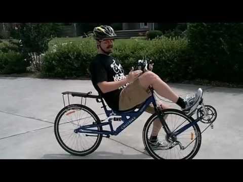

This is the fully redesigned Quest 2.0, with a range of upgrades. On the one hand, it's a lovely commuting and recreational recumbent; on the other hand, it's a compact recumbent semi-folder.

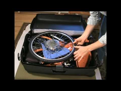

The Quest comes with 26 inch (559) wheels.  Or, you can order 20 inch (451) wheels. The 20 inch version has a shorter front chainstay which makes it easier for packing into a large suitcase.

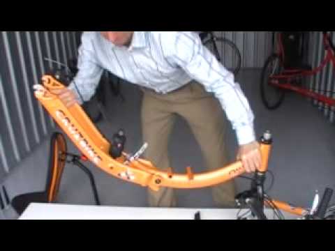

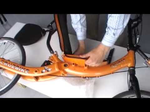

The folding process has been simplified with a seat that removes with two thumb screws and a quick release. The frame has been evaluated and redesigned with a larger diameter seat post for added strength while retaining the same weight.
A unique folding rear rack is included. The rack magically folds down against the seat-back for transportation -- beautiful!
Quick releases now fix the steering column clamp to quickly drop the bike into the trunk of a car.

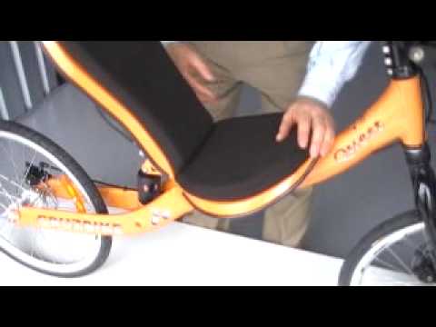

Custom Cruzbike Seat, 2 piece, The seat base and backrest are independently adjustable. Pressed alloy, matching frame color with protective rubber edge trim. The unique seat design locates the rider in position on the bike to allow you to clearly feel and enjoy the handling.
Cushions, machine washable! Dual layer reticulated polyester open cell foam on top of EVA closed cell foam enclosed in a sportswear polyester cover.
