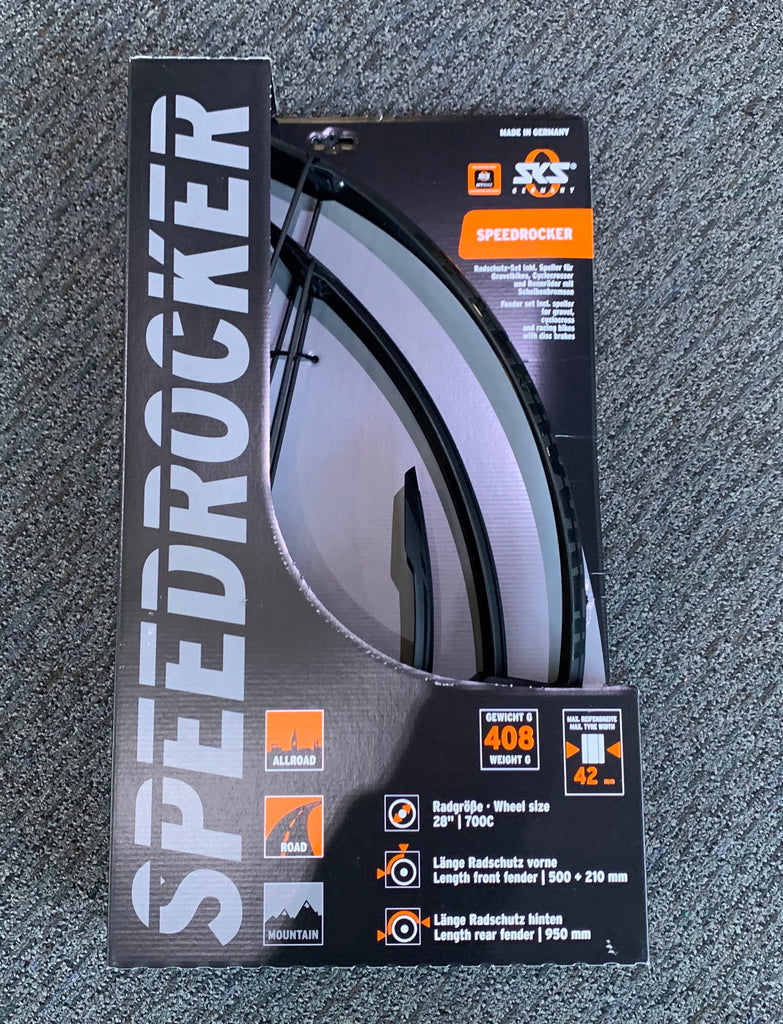

But if you are going to run the stock 700c tire/wheel combo, and still want fenders - never fear - there is a perfect option. They are the SKS Speedrocker fender set. These can be found through many local bike shops, REI, or easily ordered from Amazon here. Note: these fenders work great for the S40 and should work with a V20, but will not work with a Q or T50.
This fender set will go on your stock Cruzbike S40 and offer great full protection. Plus they make the S40 look like it came from the future! I have been using a set here personally to test and have had great success and no issues. In fact, after a week so far of testing, this set will now be my go-to for fenders for my Cruzbike.
They go on easy - just follow the included instructions, and take a look at some of our pictures here of the install. Only a small bit of strut material needs to be trimmed off of both the front and rear struts out of the box to allow for the proper tire distance, and the other brackets simply strap to the frame. The set includes protective material to add to your frame to keep the paint safe. The front fender strut mount that wraps to the fork at the top has a nice little tunnel to clear the derailleur cable that runs along the back of the fork too - perfect! The nice front fender extension completes the look and works great.
If the SKS rear fender doesn’t give you the “full wrap” type of coverage that you like, any 700c rear fender will work in tandem with the SKS front on a stock bike. Personally, this set looks and performs incredibly and for 99% of riders and the type of weather you might find yourself in - these are the bees knees. The rear also goes perfectly with the S40 rear rack.
