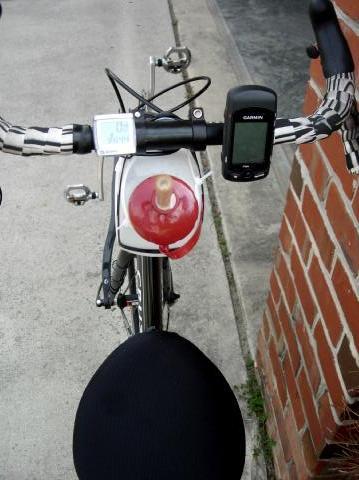

Our long distance technology is evolving. In the past, we have used water bottles attached to the backrest as the primary source to drink from. We have found a very inexpensive alternative that works well. 1.8L plastic jugs from Wal-Mart attached to the TFT with zip ties, and a straw provides a very easy hands-free way to drink. The jug sits between your thighs, with no encumberance. You can just lean forward and drink. The straw is two-part. The part in the bottle is a rigid plastic straw, and over that fits a larger diameter floppy plastic tube, that is soft and safe to have sticking up in the air.
Here are two photos of the setup. The zip ties are white, and it takes two combined zip ties to reach around the jug. The black rubber band is just for temporarily tucking items against the jug.
A disadvantage of the system is that the jugs can’t be removed for refilling on the road (unless you want to carry some spare zip ties). We just used our water bottles to refill the jugs, or purchased a gallon of water at a convenient store, and refilled them with that. Also, when the jugs are full, water can splash out around the straw when you hit a bump. We solved this problem with some tape around where the straw enters the jug. It may not look very fancy, but its affordable and makes staying hydrated very easy. -Jim
