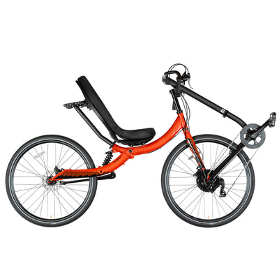

Cruzbike S40 Gen 6 Recumbent Bike Tech Specs and Fit
Frame
Front Triangle
This patented drive system not only frees us from the long, inefficient chains and special parts fixed-boom recumbent bikes require, it links the upper and lower body across the drive train as it rotates around the axis of the head tube. This linkage allows Cruzbike recumbent bike riders to increase power when climbing or sprinting by engaging the upper body in much the same way professional cyclists do when they climb or sprint on traditional road bikes.
Seat-to-Frame-to-Drive Connection
Fork
Racks and Bosses
S40 Gen 6 Complete Components
Gen 6 sees the return of SRAM. The SRAM components we have chosen deliver excellent performance and are our favorite S40 build yet. We also upgraded to full compressionless cable housing for both the front and rear brakes. Some components - the Cane Creek Viscoset, KMC chain, our proven reliable hubs - are proven to last and return once again to grace this beautiful frame.
| Headset | Cane Creek ViscoSet® Headset (This premium headset leverages viscous damping to make learning easier and improve handling) |
| Shifter | SRAM APEX 1x11 Road |
| Crankset | SRAM Apex 165 w/ 110 BCD Narrow Wide Ring (1X) 42T chainring |
| Bottom Bracket | SRAM GXP |
| Cassette | SRAM 11-42 |
| Chain | KMC X11-1 EPT Anti-Rust 1/2"x11/128" EPT |
| Brakes | TRP Spyre Dual Piston |
| Wheels and Tires | 32 spoke 3 cross black aluminum rims, aero profile, tubeless compatible, 25 mm wide rim, approx 28 mm depth non-machined sidewalls, Maxxis Re-Fuse 700x32c tires |
| Thru-Axles | The latest in high-end cycling axles attach the wheels more securely, are stiffer and flex less than their quick release predecessors, resulting in better power transfer and more resilience. For the new thru-axle on the S40 we chose a sleek, leverless style that even houses its own internal removal tool for the axle itself and brake rotors. |
Compatibility Notes
BB shell: English Thread 68mm
Front derailleur: Braze-on mount
Brakes: Flat mount
Brake adapters: 160/200 size front and rear for 160mm rotors (this will be brand dependent).
Hub spacing: the front fork is compatible with standard 142 12mm thru axle. The rear dropout is compatible with standard 100 mm hubs.
Hydraulic disc brakes: The S40 Frameset can be outfitted with hydraulic disc brakes using readily available long brake line kits. The exact proper length will be different for each bike/owner due to handlebar fit variations. Work with your local bike shop on this.
Weight
| Complete | 29. 3 lbs (includes pedals, cushions and headrest) |
| Frameset | 15 lbs (final weight of custom built frameset will vary based on component choice.) |
| Mainframe | 5.3 lbs |
| Handlebar | 0.65 lbs |
| Cushions, handlebar wrap, through axles, headset and clamps: | 1.65 lbs |
| Chainstay and chain stay clamps | 0.75 lbs |
| Boom and slider with pivot clamp and boom clamps | 2.1 lbs |
| Headrest | 0.55 lbs |
| seat with extension and hardware | 2.45 lbs |
S40 Geometry
| Wheelbase | 1130.3 mm | 44.5 in |
| Chainstay length - standard | 450 mm | 17.75 in |
| Rake (front fork offset) | 30 mm | 1.2 in |
| Head tube angle (steering axis) | 71 degrees | |
| Trail | 91.44 mm | 3.6 in |
| Backrest angle | 40 degrees | |
| Length of Bike (varies by adjustment and chainstay length) | ||
| Seat Height (low point) | 609.6mm | 24 in |
| BB Height (varies by adjustment) |
Fit
The S40 fits riders with an X-seam between 35 inches and 48 inches (about 5'2" to 6'5" body height). Check out the 2021 S40 Fit video here and head over to our Fit page for more great resources on fit.
